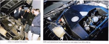

Playing around with air boxes to see what might work. If nothing suits from the MB parts bin I might have to go custom like most other parts for the EFI.
5,980
Note the inlet is much larger than that from a 6.9 and quite a bit bigger than a 560 (on one side & maybe not when you combine the 2 inlets).
