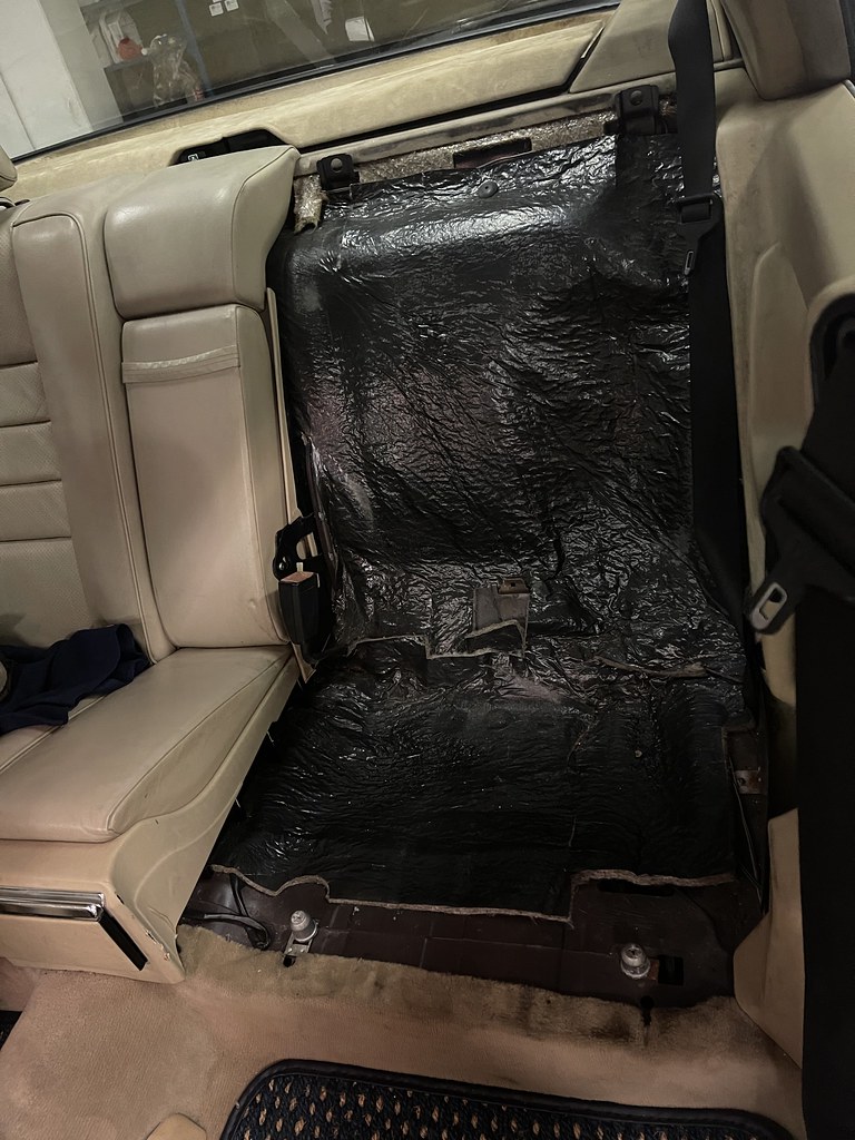

Did rear speakers last night too.

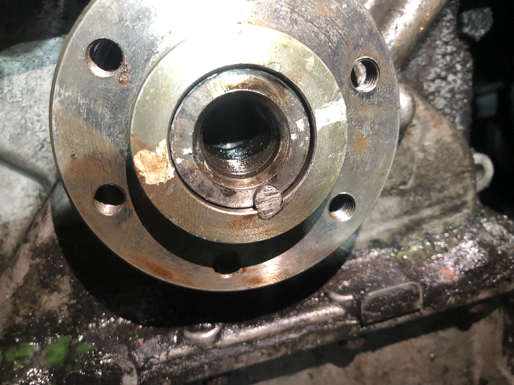

Once the problem was diagnosed the prognosis was not good.
The crank pully and the harmonic balancer bolt to a sort of flange and it had cracked and had destroyed the woodruff key that holds it in place and done some damage to end of the crankshaft.
The worst case scenario was a new crank, but we wanted to try other things first.
I sourced a second hand flange to start with.
This replaced the broken part, but the woodruff key slot was damaged to the point where a new key would not work. The new flange also had to be slightly modified as the ruined woodruff key had sort of melted onto the end of the crank making it thicker at the inner end. To fit it, my mechanic got in the guy who does the thread repairs to cars for him, and they drilled a hole to insert a dowl to hold it in place.
This is the last update I got on friday, so I assume its all going together and I'll have the car back soon.
140
101
Fwiw in an engineering sense I think a dowel pin is better than a woodruff key. The key will always bear the load on two edges in the rectangular slot, and an edge and a point in the secant slot, so stress concentration is guaranteed as soon as the vlamping force of The Big Fat Nut isn't enough or, gasp, isn't used at all by design (dunno if that applies here, hope not, mercedes engineers not being known for poor training etc).
Assuming a strong enough dowel you should be able to virtually drive the accessory belt indefinitely with the BFN finger tight by comparison, as the dowel will just try and gently stretch the flange collar (which I assume has the crank pulley around it as a further constraint as well).
3,733
This is the old flange.
The guy who did it does this mod to American V8’s that get a supercharger. It puts too much load on the crank otherwise.
Ultimately it should be stronger than new but the down side is the dowl needs to be drilled out if you want to replace the front crank sealIMG_1837.jpeg
