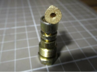

Sinterfilter from thomasjj2 on ebay. It can also be cleaned and reused.

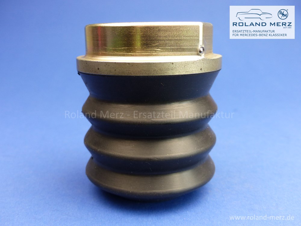

New reproduction bumpstops from Roland Merz in Germany.

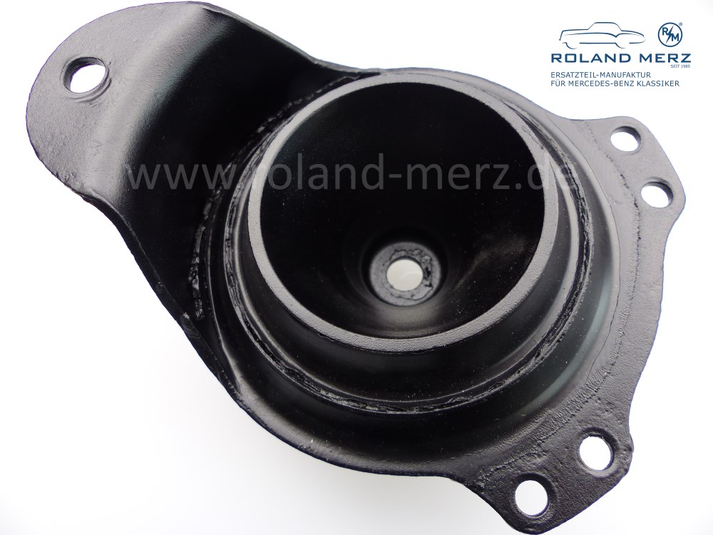

Rubber mounts can be reworked by Roland Merz but i chose not to:
