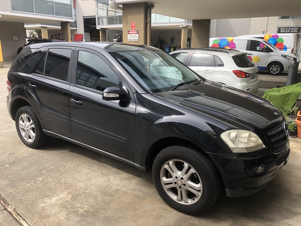

There were some delays getting timing chain guides from Singapore for a month. So we had the loan car for a number of weeks. Loan car was an 05 w164 ML350.
I know there are fans of the ML on this site but I was very disappointed by the car. Poor ride, cheap interior, bigger car but less space unless you wear a top hat. Having said that it was great to have a loaner and do the comparison.
