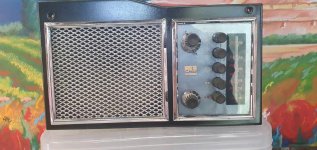

I have decided to splash out a little and have bought an original radio that has been converted and has DAB, Bluetooth and hands free. Funny enough the one I am getting has the same fascia colour as my interior, creepy lol

That looks awesome.
Does it have a seperate antenna for DAB?
I recently fitted one to my Mini, and it has a window mounted antenna as a normal antenna won’t pick up DAB.
Just interested in how this one is done.

Hi Patrick
I just asked the guy who builds these and his response
Not necessary David. It has a state of the art inbuilt receiver making an external aerial unnecessary

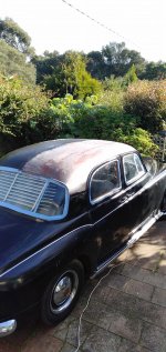

Well here we are again. Auntie was in dire need of a roof paint so I thought I would give the Coopers stripper a go as I have had it for over 12 Months and the reviews were good. I decided to only do half the roof today as a test for both effectiveness and time factor. The pic shows the result after approx 90 Minutes. It was first sprayed with Coopers and a scraper took off the top layer. A second spray and a bit more scraping to remove some stubborn bits and then, a light spray as I went over the surface with steel wool. Once done it was wiped down with their "flush" to remove any crap and the final result speaks for itself. Very happy with the product and the end result. The other half I will do over the weekend and it will be painted next week all being well.

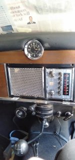

Another few hours well spent this morning. t took a bit of fiddling around but the new old radio is now in place. I still have to remove those hinges which is not a job I am looking forward to but all in all a good result. Had to take the inner lining out of the glove box to get a nice fit but, it came out easy with no damage.
That radio looks so good in the dash of your P4
