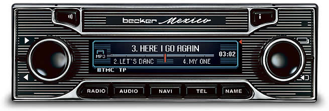

Becker Mexico Retro 7948
http://www.soundlabsgroup.com.au/p/Becker-Mexico-Retro-7948/Becker+Mexico+Retro+7948

That Becker Retro really is the "Ducks Nuts" but a lot of the features including Satnav do not work outside Europe.
I saw it in the Harmon-Becker Shop in Dubai last year but "She who must be obeyed" started frowning at me.

Honestly guys, without wishing to sound rude, crude, uneducated and whatever else one could be levelled with, the price of that Becker Mexico is quite indecent - it triggers the same sort of reaction when I think of CEO's getting the indecent sort of payouts and salaries they are privy to nowadays.
I really would like to do without that insult to the everyday people.
