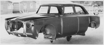

The bodies were delivered by road to the Rover factory, which had no direct rail link. They arrived as BIW (Body In White, ie bare metal) assemblies. As a first stage, their undersides were treated with Bittac sound-deadening compound (not underseal, as is sometimes suggested), and they were then primed and painted. From the Paint Shop, they passed to an initial preparation line that appears to have been the start of a U-shaped moving assembly line that ran up and down the length of the South Block. (As far as I know, there was only ever one assembly line for the P5 models, because they were built in relatively low volumes.) On this body preparation line, they received glass, window winding mechanisms, door lock mechanisms, and some lighting elements. Protective sheeting was then added before the next stage began.

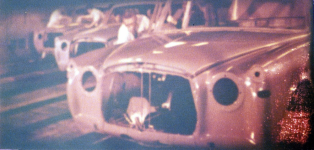

The front-sub-frames were meanwhile put onto their own track in a separate sub-assembly area within the South Block, and here they were fitted with suspension and steering components, and with engines and transmissions. Each assembly was mounted on a trolley that ran on its own track, and was subsequently transferred to a main track where propshafts and rear axle assemblies were added. The rear axle, with its leaf springs attached, was mounted in a special rocking frame to aid positioning during assembly.
Each drivetrain assembly then proceeded to the Body Mounting area, where the sheeted bodies were hoisted from their assembly track across to the drivetrain line, to be lowered onto a drivetrain and bolted to it. This was achieved from pits underneath the moving assembly line. The track then took the newly combined assemblies to the Body Trim area, where they were fitted with carpets, seats, other items of interior trim, brightwork and bumpers. I presume the instrument panels were also added at this stage of assembly rather than during the first stage of body assembly.
